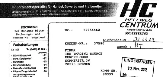

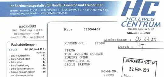

Since a filesize-optimized scanned document is probably going to be black and white, .pbm is a monochrome bitmap format that seems perfect for this, and you can covert that back into a png to embed in a pdf.
Using a sample document1 (imgur permalink: https://i.sstatic.net/2WjRh.jpg)
Original Document
Its a 1751x2451 jpg scan of a document, size 1.71MB, black and white with some blue accents
convert document_scanner_sample_scan_00_zoom.jpg -resize 1000 intermediate.pbm
convert intermediate.pbm page1.png # 1000x1436, 46kb
page1.png looks quite presentable for 46kb (https://i.sstatic.net/DYh6R.png)
Optimized Document
As pointed out in comments, the png needs to be transcoded to be embedded in the pdf. convert uses /FlateDecode pdf compression format by default (convert page1.png page1.pdf) and the resulting pdf is 67kb. Use the /CCITTFaxDecode format instead, which is for monochrome images, to get that down to 57kb
convert page1.png -alpha off -monochrome -compress fax page1.pdf
See the image magick documentation for a mapping of command line options to pdf compression format: https://legacy.imagemagick.org/Usage/formats/#pdf_compression
For documentation of the pdf compression filters, see section 7.4 of the pdf reference (version 1.7). An introduction is provided in section 7.4.1 Table 6.
https://www.adobe.com/content/dam/acom/en/devnet/pdf/pdfs/PDF32000_2008.pdf
