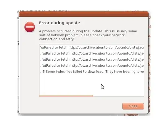

I've been trying to upgrade my ubuntu 11.04 desktop computer, but when I click on the ugrade button:
I get this error:
I've tryied to change my repositories, but it changes nothing in the error((on the "setting new software channel"). enter image description here
Can someone point me in the right direction?

You need to remove any jaunty related repositories from your sources list or sources list.d/*.
The reason I jump straight for jaunty is that in your screenshot, the archives that are failing have jau as the start of the distribution name.
It may be finding deb-src http://pt.archive.ubuntu.com/ubuntu/ jaunty-backports main restricted universe multiverse or there may be something else in your sources.list.d.
You can edit your /etc/sources.list.d with a text editor like this. If you're going to edit it make a copy first. Like that answer says, you need to be very careful editing system configuration files.
RobotHumans
  • 30,112
Check if you can ping pt.archive.ubuntu.com, if this does not work ... try modifying your
/etc/apt/sources.list
to remove references for "pt" and leave "archive.ubuntu.com". This will effect your download speed for new installs and updates but it may resolve the issue.
