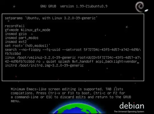

You could boot to a live CD and edit GRUB that way, or you can do it whilst in GRUB itself, much faster:
  • Highlight "Ubuntu" in the GRUB menu, but rather than hitting Return to boot Ubuntu, hit the letter e. This will take you to an editor.
If you never see a list of operating systems to boot, holding Shift as the computer loads will display it.
  • Add acpi_osi=Linux acpi_backlight=vendor at the end of the second-to-last line, as shown in the picture:
See the second-to-last line.
  • Hit F10, which will boot Ubuntu, backlight and all.
  • You can then make the change permanent by following the instructions in the answer you referred to.
