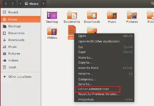

Now that the tool is installed, all you have to do is open Nautilus file browser, right-click a file or folder and select Open As Administrator as shown in the image below…
First run the commands below to reload Nautilus…. sudo nautilus -q
screenshot
When you want to edit files, you’ll see Edit as Administrator… on Folders, you’ll get Open as Administrator. Doing that will prompt you to type your password… this only works if your account is already member on the sudo approved list.. if the user opening a file isn’t authorized to use the sudo command, it won’t work…
