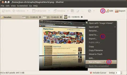

I am using Shutter Download Shutter.
If you don't find it, you can check the detailed installation instructions which will give you a PPA for it.
It's a really handy screen capture application with easy to use plug-ins to give a nice touch to your screenshot and as many other to easily share the files.
It offers in-house image editing and special effects (via plug-ins) to enhance the quality of your screenshot. You can access this options via the menu (1), or the toolbar (2).
alt text
The effects here are all done with Shutter (Plug-in Reflexion and Edit auto-increment shape).
And then to publish them, I just right click in Shutter and choose Export (3). Then I publish it via Ubuntu One. I go to the directory where I published the file, right click on it and select Copy Ubuntu One public URL.
Finally here when I comment, I click on img in the small tool bar and select From the web and paste the link that was copied in the previous step.
It's easy and fully integrated.
For those on 10.04, check that you have all shutter dependencies. As you might miss some of the plug-ins. For user on Ubuntu 10.10, this should be fixed.

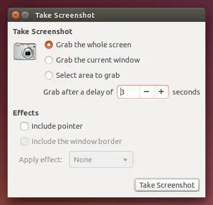

GNOME Screenshot Download Gnome Screenshot
I find the GNOME screenshot tool to be the most effective of all. And it is installed by default!
My favorite is the use of shortcuts to quickly generate images. For example - Print Screen which takes the entire desktop and Alt+Print Screen for the current focused window.
Furthermore the interface is extremely simple and powerful for such a small tool.
Screenshot showing Gnome Screenshot interface
It provides nearly the same functionality as the Snipping Tool in Windows via the Select area to grab option, but you can also make a screenshot of a window without the window frame and shadow.

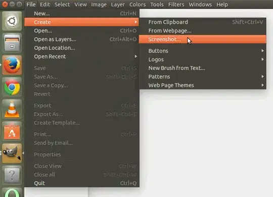

I use GIMP. It has a nice tool which allows you to pause (to move it out of the way) and to select just a portion of the window. Usually I crop or edit a screenshot after taking it, so I want to be in GIMP anyway.
GIMP 2.8.10 on Ubuntu

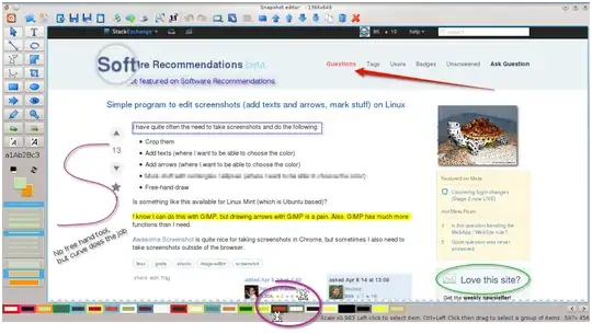

HotShots
Answer from SoftwareRecs. Note that, as of November 2016, HotShots hasn't been updated since 2014-Sep. The same can be said for Shutter, unfortunately.
Hotshots is a screenshot tool with some editing features. It is particularly suitable for writing documentation, but you can use it to highlight some details on a map image or what ever you want.
Features
Some important features:
  • Free/libre software and gratis
  • Can take screenshots: all screens, full screen, window, region, free hand region
  • Can crop those screenshots or any image inside its editor
  • Can add texts (where you will be able to choose the color)
  • Can add arrows (where you will be able to choose the color)
  • Can mark stuff with rectangles / ellipses/ polygons/ curves (where you will be able to choose the color)
  • Can use “system” shortcuts to take a screenshot.
Platform support
  • Linux (needs compilation such as on Slackware Linux; Download) -- libXfixes and libqxt would be needed before compilation. Also, developer says that compiled packages are also available for Ubuntu and Arch Linux.
  • Windows XP/Vista/7/8
Usage
HotShots is pretty simple to use (similar to KolourPaint, MS Paint or GIMP, if you used any of them), and you may refer to its guide in case you need to know more. As for the asked features, I have put them in an screenshot.
In the following screenshot, you would find:
  • the interface of the HotShots
  • zoom in on "Soft"
  • custom text written below website's title
  • a red colored arrow pointing to Questions
  • a rectangle bordering first line of your question's body
  • an image of a turtle added where question's stats were visible
  • blurred the fourth requirement of your question's body
  • made a free curve to make up for free hand requirement accompanied by a text box below it
  • highlighted with yellow color a line of the body
  • enclosed "Love this site?" by an ellipse
  • encircled kittens roaming on my desktop
IMG: HotShots features

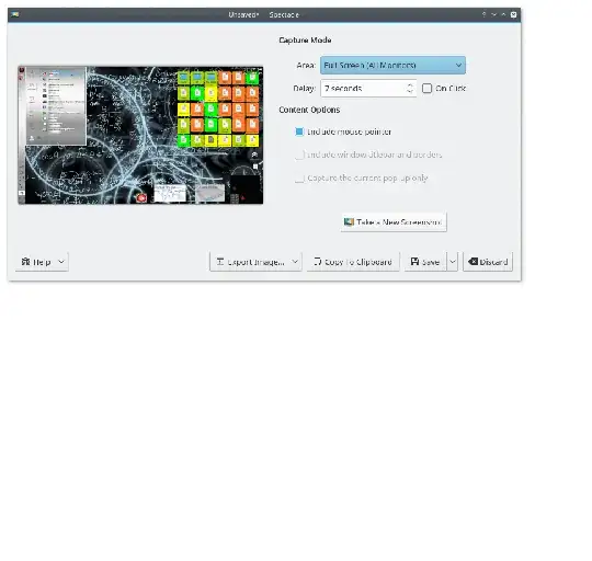

Spectacle
KDE Framework 5 default screenshot capture utility is the Spectacle.
Spectacle is a simple application for capturing desktop screenshots. It can capture images of the entire desktop, a single monitor, the currently active window, the window currently under the mouse, or a rectangular region of the screen. The images can then be printed, sent to other applications for manipulation, or quickly be saved as-is
Spectacle - Development Information: https://www.kde.org/applications/graphics/spectacle/development
