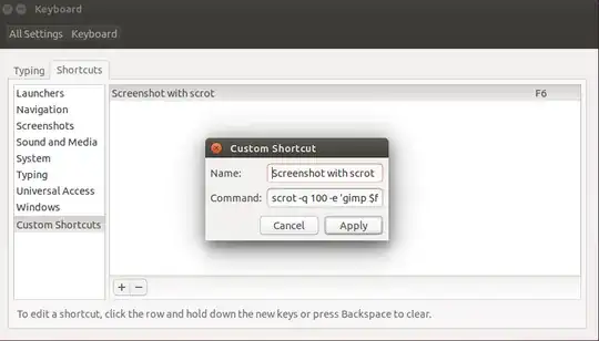

You can set this particular commandline to a key, I illustrate here mapped to F6:
Or you can simply run it from the commandline with the glorious addition of a timer and delay:
scrot -d 10 -c -q 100 -e 'gimp $f'
The gimp should make short work of your image manipulation needs and there are many other scrot settings which you can tailor to your needs...
