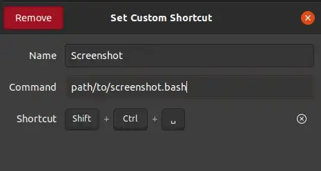

No installation needed. Customized to your needs.
  1. Place the following command in a file named screenshot.bash anywhere you want.
    gnome-screenshot -a -c -f /home/<username>/Desktop/Screenshot_$(date +"%0y%0m%0d_%0H%0M%0S").png
  2. Copy the location of this file.
  3. Go to "Keyboard Shortcuts" and create a new one by hitting + at the end of the list
