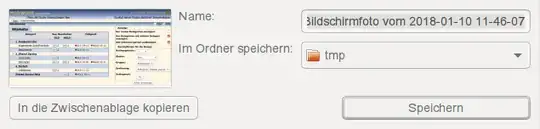

If I take a screenshot, often the next action is to paint on it. Sometimes I paint a circle around something, sometimes I blank parts to anonymize them.
Below is an example of the window after the screenshot was taken:
example-screenshost
It would be great if I could directly go to "edit image".
BTW, I use Pinta, not Gimp.

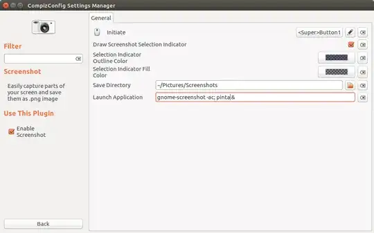

Making it Work With Pinta
The original question implied that Pinta was the desired program to be used in editing the screenshot, so this is how you make that happen:
  1. Install CCSM and it's extra plugins with this command line: sudo apt install compizconfig-settings-manager compiz-plugins-extra
  2. Configure the Screenshot plugin as shown in the picture below
  3. To take a screenshot, hit Super+MouseButton1.
  4. The crosshair will appear, and you select the area of the window you want to take a screenshot of.
  5. After completing the selection, Pinta will open.
  6. Hit Ctrl-V to paste the screenshot into Pinta.
If you can figure out how to get Pinta/GIMP to open with the contents of the clipboard, then it is exactly what you want.
For others reading this post, if you want to use GIMP instead of Pinta, just change pinta to gimp, in the Launch Application setting as shown in the CCSM window below.
