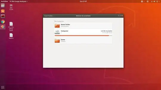

Now, df still has /dev/sda6 as being almost full:
eric@cpr-mic09:~$ df
Filesystem     1K-blocks      Used Available Use% Mounted on
udev             4014820         0   4014820   0% /dev
tmpfs             807508      2892    804616   1% /run
/dev/sda6      114756748 109069280   5671084  96% /

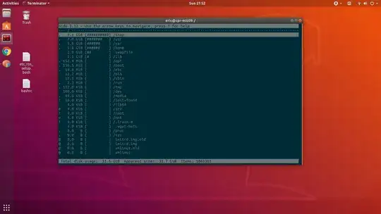

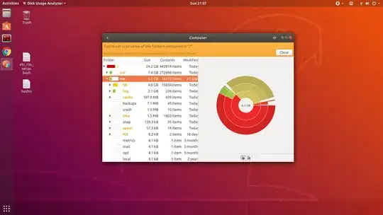

I tried using du to see if there were any obviously large files, but nothing looked out of the ordinary. I also used lsof to try to find deleted files sudo lsof | grep deleted (source). I even went so far as to just kill everything that lsof returned (source):
$ kill -9 $(lsof -ti | awk "{print $2}")
Nothing I have done so far has been able to get the Disk Space to free up. I've rebooted multiple times to no avail. Below are some relevant screenshots. I would really appreciate any advice.
