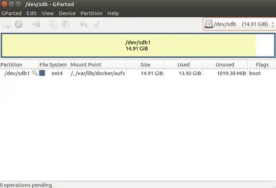

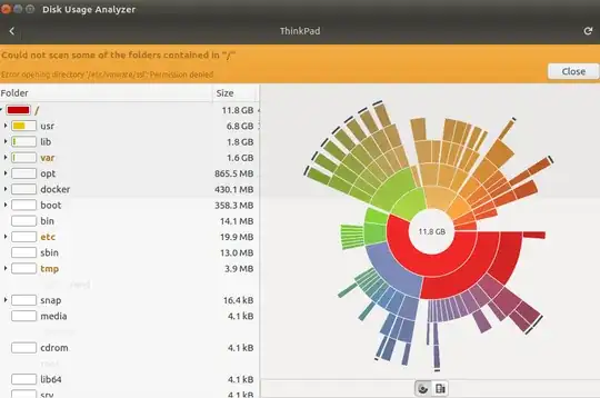

Disk Usage Analyzer

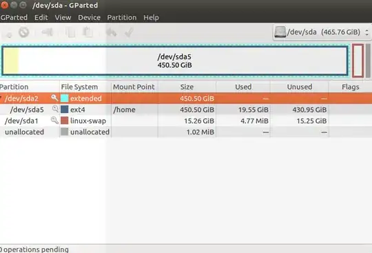

I also got gparted:
on this one there is almost 500GB 500GB
Here is the culprit: 16GB cap
Here is some more data

➜  ~ sudo parted -l
Model: ATA ST500LM021-1KJ15 (scsi)
Disk /dev/sda: 500GB
Sector size (logical/physical): 512B/4096B
Partition Table: msdos
Disk Flags:
Number  Start   End    Size    Type      File system     Flags
 2      1048kB  484GB  484GB   extended
 5      1049kB  484GB  484GB   logical   ext4
 1      484GB   500GB  16.4GB  primary   linux-swap(v1)
Model: ATA SanDisk SSD U110 (scsi)
Disk /dev/sdb: 16.0GB
Sector size (logical/physical): 512B/512B
Disk Flags:
 1      1049kB  16.0GB  16.0GB  primary  ext4         boot
So looks like I have a lot of space thats not being used?
Your problem is here...
Filesystem     Type      Size  Used Avail Use% Mounted on
/dev/sdb1      ext4       15G   14G  240M  99% /
your / partition is full... well, the real problem is that your / partition is too small. It's too small of a SSD for this. Ubuntu / partitions should be no smaller than 20G, and 30-60G is more realistic. You can probably get rid of some old Ubuntu kernels in /boot, and if you search here on Ask Ubuntu, you'll find plenty of instructions on how to best do that.
Another idea would be to build a bootable system on the 500G and use the 16G SSD for something else.
