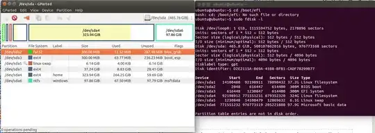

Please see the screen shot below. This is how my disk looks like:

So the questions are: Can I install Ubuntu 14.10 with only 4 parts: "/", "/boot", "swap" and "/home"? What the partitions are odd here? (in the example above)
Short answer: What Timur Fayzrakhmanov wrote is right, replace the /boot-partition with an EFI partition.

To install Ubuntu on GPT drive and UEFI there is must be "EFI boot partition". The other partitions like "/home", "/boot" are optional. For me optimal are the following partitioning:
  1. EFI boot partition
  2. swap
  3. / (root)
  4. /home
and that's all)
