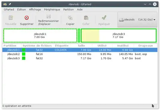

You can use any program you like : gparted, fdisk, cfdisk (a command line tool for fdisk)... Then do the following operations
  • First start the program (sudo gparted or sudo fdisk /dev/sdX depending on the program you choose)
  • Then reset your device to have a msdos partition table (in gparted it's in "Device/Create a new partition table", with fdisk type o.
  • Then create three partition. The first one is in FAT32, it will be the partition of data (it could also be NTFS, ext, or any other filesystem), the second one is an EFI partition (based on FAT) and must be bootable and around 150M, the last one is the partition with the iso, and must be bootable and in FAT32 (if you use ext2, if will boot, but you wont be able to use persistence). Here is what you would like to have at the end of the process (please, note the flags (drapeau in the picture), they are important) :
gparted result
If you want to create them with fdisk, you should have something like this :
$ sudo fdisk -l /dev/sdc
Disque /dev/sdc : 14,3 GiB, 15376000000 octets, 30031250 secteurs
Unités : secteur de 1 × 512 = 512 octets
Taille de secteur (logique / physique) : 512 octets / 512 octets
taille d'E/S (minimale / optimale) : 512 octets / 512 octets
Type d'étiquette de disque : dos
Identifiant de disque : 0x2d844503
Périphérique Amorçage    Début      Fin Secteurs Taille Id Type
/dev/sdc1                 2048 14682111 14680064     7G  b W95 FAT32
/dev/sdc2    *        14682112 14989311   307200   150M ef EFI (FAT-12/16/32)
/dev/sdc3    *        14989312 30031249 15041938   7,2G  b W95 FAT32
