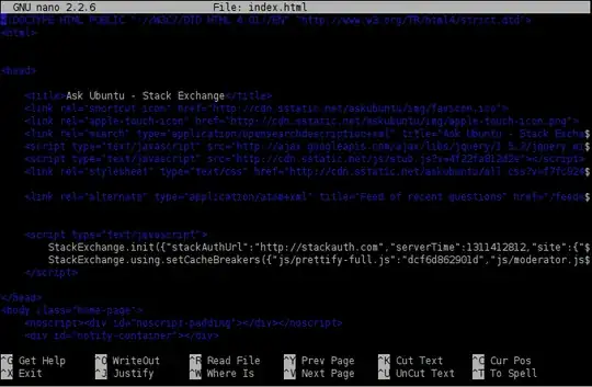

Sometimes, a graphical text editor like gedit or kate cannot be used (because you're in a virtual console for example). Luckily, there are text editors for the terminal. An easy one is nano, but I cannot understand how to work with it.
If I start nano by running nano, the bottom text is supposed to help me but all I see are things like ^G Get Help ^O WriteOut.
  1. How can I open text files for editing?
  2. How can I save the file?
  3. How can I quit the editor without saving the changes?
  4. How to edit? I heard that you've to enter some commands to begin editing in vi, is this true for nano too?
  5. Sometimes, if I manage to open a file, the text is unreadable due to its colors. How can I disable these colors? (see the image below)
  6. In the some files, lines are truncated because those do not fit in the screen. How can I prevent that from happening? (see the image below)
nano screenshot
Colours are loaded through the nanorc framework. These are files that are loaded when nano loads which basically spell out the syntax highlighting. To toggle syntax highlighting, press Alt + Y. To disable it permanently for certain file types, edit /etc/nanorc and put a hash mark (#) before include "/usr/share/nano/*.nanorc".
Well I've been trying to find something but the best I could see was enabling soft-line-wrap with the funky key-combination of: Alt + $ (Alt + Shift + 4). To enable soft line wrapping by default, add the below line to ~/.nanorc:
set softwrap
More information about this configuration file can be found at man nanorc.

So^G is Ctrl-G and M-Y is Alt-Y (that one toggles the colors).
You can toggle line truncation with M-$. See the help pages (^G) for more functions.

  5. Syntax highlighting is disabled in a hidden file called .nanorc in your home directory along with other options. Alt+Y toggles it.
  6. In the aforementioned .nanorc you can add the line set fill 80 which will break long lines at 80 characters length. Alt+M toggles it.
