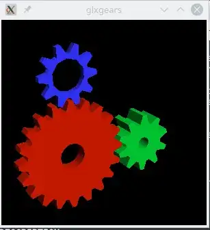

In my case the solution to this issue resided in the continuation of the error message
Paraview 5.7.0 informed me that:
libGL error: No matching fbConfigs or visuals found
libGL error: failed to load driver: swrast
(   0.833s) [paraview] vtkOpenGLRenderWindow.c:748 ERR| vtkXOpenGLRenderWindow (0x5588ae6a2160): GLEW could not be initialized: Missing GL version
Segmentation fault
The message
has been key. I run 'glxgears' to check that the graphics libraries were running fine -- see also man glxgears -- showing this animation:
screenshot of glxgears
Then my solution was simply setting the environment variable
LD_PRELOAD=/usr/lib/libGL.so
Take note:
  1. Although I have a Nvidia graphics card, I did not need to fiddle around with it;
  2. Launching locate libGL.so, I find another candidate /usr/lib/i386-linux-gnu/libGL.so. Setting this as LD_PRELOAD, however, did not fix the problem;
  3. No need to set any information about the GLEW library appearing above either --- see locate libGLEW.so
I am indebted to https://github.com/openai/mujoco-py/issues/44 for clues
