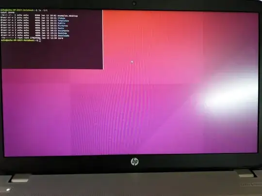

enter image description hereThanks cl-netbox to some extent I am able to resolve the issue. This is what i have done
sudo add-apt-repository ppa:graphics-drivers/ppa
sudo apt-get update
sudo apt-get install nvidia-358
sudo reboot
Please make sure that if you went to the nividia website and installed the driver from there(N*.run) - you must un-install this by going to /usr/bin/nvidia-installer. There should be something like nvidia-install(link to uninstall). Run that one and follow all the instructions. You should install the nvidia drivers from the ppa repository after cleaning up(purging the previous nvidia install). There is a bug in ubuntu and any time there is any issue in terms of installing the nvidia driver - you will end up with login loop.
I am out of the login loop issue. The only issue that i am facing now is that once i login into Unity desktop-i am not seeing sidebar...(resolution issue)-terminal etc....are not having the title bar etc....so it seems some more steps are needed to fix the entire set. But yes I am out of that irritating login loop issue now.
Next update - I was missing the sidebar via which i can launch applications and that got fixed via: Was able to get rid of the unity desktop issue also finally. I was able to do Right click and open the terminal. Tried many solutions as mentioned in this thread as well as others. Finally this worked for me.
dconf reset -f /org/compiz/
then
setsid unity
Everything seems to be working fine now. Thanks everybody
