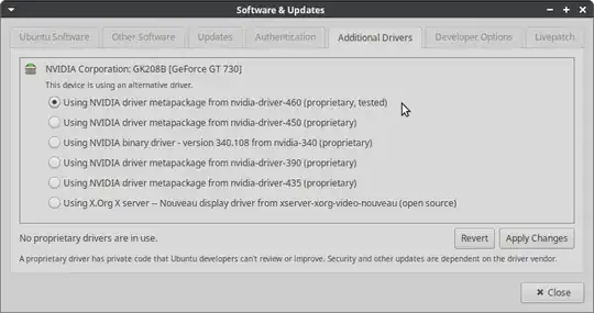

Note for the impatient: When I had launched the installation, it reminded me that there might be better-integrated drivers available in: software & updates --> Additional Drivers
Lo and behold - there was, and the metapackage had the same major release number as the one I had just downloaded (460.32). (see screen shot at the end).
So, I installed the most recent one, and after a day, I have not been bothered by all the weird video and xserver hangs that had been plaguing me multiple times per day.
Kudos to nvidia and ubuntu for keeping the drivers so wonderfully up to date.
