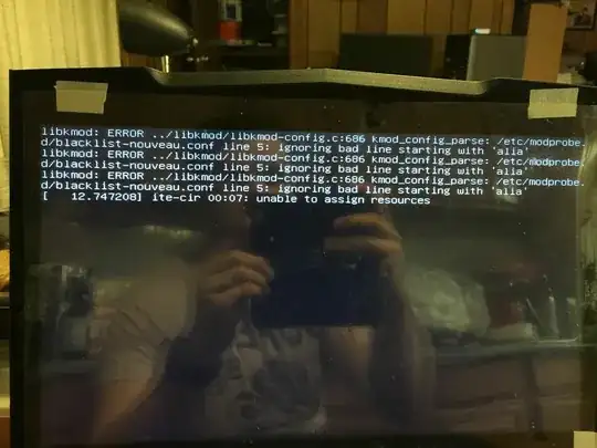

libkmod: Error ../libkmod/libkmod-config.c:686 kmod_config_parse: /etc/modprobe./blacklist-nouveau.conf line 5 ignoring bad line starting with 'alia'
Phone picture of error
I started getting this recently then today it fails to boot into Ubuntu just giving me a blank desktop background. I think it has to do with this manual way I went about installing the nvidia drivers? If it is how is the normal process for installing the drivers because this process is awkward to say the least!

It seems that the file /etc/modprobe/blacklist-nouveau.conf contains the invalid verb alia in line 5 which should probably be alias. Are you sure you copied the code listing from the referred answer correctly? It should read:
blacklist nouveau
blacklist lbm-nouveau
options nouveau modeset=0
alias nouveau off
alias lbm-nouveau off
