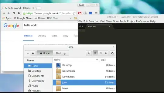

I have a 3200x1800 ultrabook and I would like to decrease the resolution of the screen 2x. The problem is that once I do it all the GUI elements increase in size too much
Is there a way how to scale down the size of everything that Gnome Shell shows ?

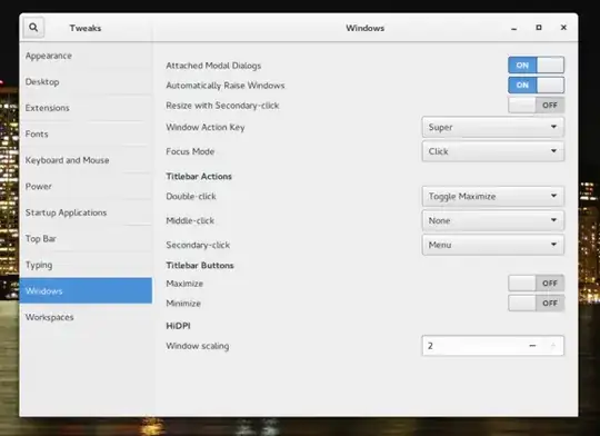

Your best bet is to keep the 3200x1800 resolution and just change the interface scaling factor of GNOME.
Command line method:
Open a terminal (Ctrl+Alt+T) and execute :
gsettings set org.gnome.desktop.interface scaling-factor 2
You can reset this setting later by running :
gsettings reset org.gnome.desktop.interface scaling-factor
Graphical method:
You can use the gnome-tweak-tool:
sudo apt-get install gnome-tweak-tool
Go to "Windows" and set "Window Scaling" to 2:
gnome-tweak-tool screenshot
Credit to PCWorld for the screenshot
