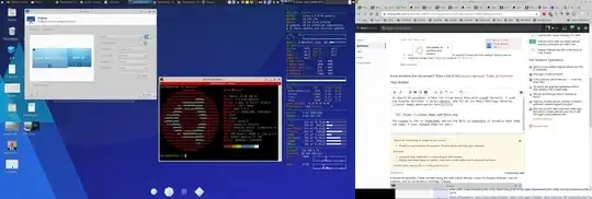

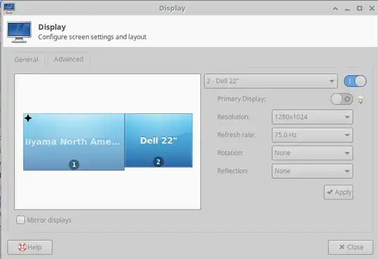

It should be possible. I have not tried doing this with xrandr directly. I used the Display Settings. I am on xUbuntu, and for me its Menu->Settings->Display enter image description here
The Iiyama is set to 1920x1080, whilst the Dell is 1280x1024 (I normally have them the same, I just changed them for you!) enter image description here

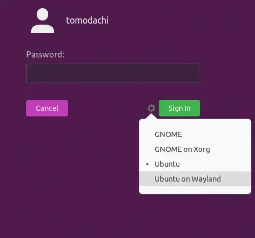

What you want is Display independent DPI scaling. Which automatically change size of windows depending on the the screen they are on.
This isn't a supported in Xorg. But one of the main benefits of Using Wayland which is the long awaited successor to Xorg.
Ubuntu hasn't yet changed it to the default so you have to select it from the login screen like this:
All Xorg applications need to add Wayland support for the DPI scaling to work. So it wont work for all programs.
Legacy applications will not scale up / down on different screens as they are running in a rootless Xorg under Wayland.
All gnome application work so you can try with files or terminal. Firefox also support Wayland natively.
