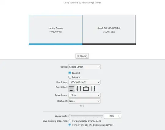

I have a laptop and a monitor connected to it. I would like 125% scaling on the lapop and 100% on the monitor. Changing any settings changes the scaling on both monitors. I would like to scale 125% laptop separately. 100% monitor.

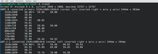

xrandr --output eDP-1-1 --scale 1.25x1.25:
piotr@piotr-Dell-G15-5510:~$ xrandr --output eDP-1-1 --scale 1.25x1.25 --mode 1920x1080 --fb 2400x1350 --pos 0x0 --output HDMI-0 --primary --scale 1x1 --mode 1920x1080 --right-of eDP-1-1 xrandr: specified screen 2400x1350 not large enough for output HDMI-0 (1920x1080+1920+0) xrandr: Configure crtc 0 failed piotr@piotr-Dell-G15-5510:~$
