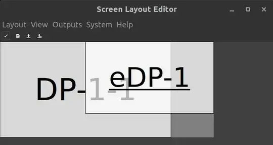

edit:
Just in case, if you meant
xrandr --output DP-1-1 --scale 2x2 --mode 2560x1440
xrandr --output eDP-1 --scale 1x1 --mode 3840x2160
I tried it, the screen still overlapped and arandr didn't let me set them appart : enter image description here
