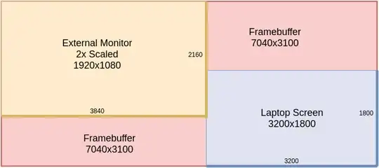

My desired setup
This image shows what my setup is supposed to look like. I applied those settings with
xrandr --output DVI-I-1-1 --scale 2x2 --mode 1920x1080 --fb 7040x3100 --pos 0x0
xrandr --output eDP-1 --scale 1x1 --pos 3840x1300 --mode 3200x1800
DVI-I-1-1 is my external monitor, eDP-1 my laptop's screen.

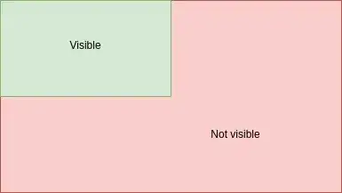

This does not have the desired effect, and on my external monitor I can only see the upper left quadrant of the "big 3840x2160" Montior.
What I can see on the screen
So if here the big red rectangle is the whole image I'm supposed to see on my external monitor, the green rectangle is what I'm able to see. On the Laptop's screen everything is fine..
Any ideas on what I'm doing wrong here? I couldn't find good explanations on how xrandr is supposed to work, only people posting the solution to their very specific setup. I would like to understand what is wrong here... Thanks! :)
TLDR: what is wrong with my xrandr commands that I can only see 1 quarter of what I'm supposed to see on my external monitor

Wow , you have the same issue as me in that scale try's to work but only shows 1/4 of the final result on the screen .
Facts first
I can get it working just working with the nvidia chip by it self ,
It's when in Hybrid mode ,and try to scale it starts to crumble to a pile of do do
Funny thing as the mouse pointer is able to work fine over the screen in the correct scale ,
It's only taking a 1920x1200 chuck in my case of a 3840x2400 of the upscale image and just displaying one 960x600 chunk on the 1920x1200 screen .
It's like it's selecting only 1920x1200 of the 3840x2400 scaled image. And passing that to the frame buffer to be displayed .
