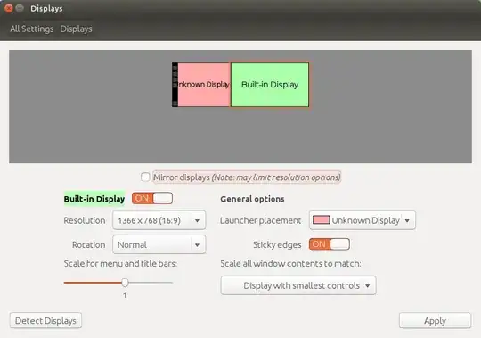

However, GUI is quite capable of doing that same task - review System Settings -> Displays settings
