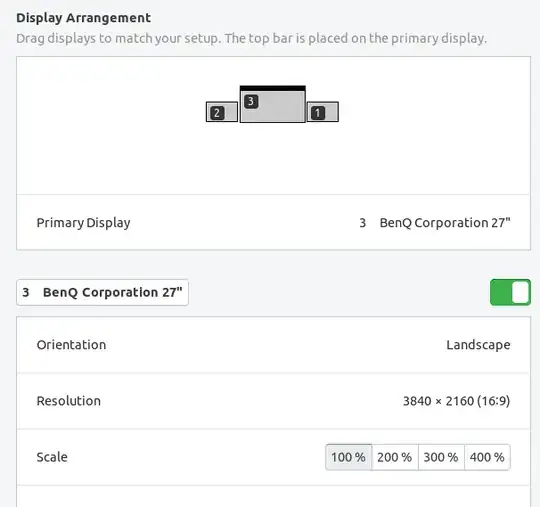

edit: This is the situation as it appears on my system below. I could make the screens align to the top (making the "break" at the bottom of the screens), or move them to the middle where the mouse would catch every time at both the top and the bottom (most un-ideal).
Reading over the solutions that have been presented recently, I have played extensively with the GUI settings and no amount of what I have available to me allows me to achieve "alignment".
Utilising the scale option affects ALL monitors and does the reverse of what I'd like. Going to 200% (which if applied to a single monitor, I could handle), blows up all screens to 200%. If I could blow up JUST the side monitors, I'd be happy. YES, they'd be grainy and ginormous, but I would have specific things on that screen that suit what's being displayed there.

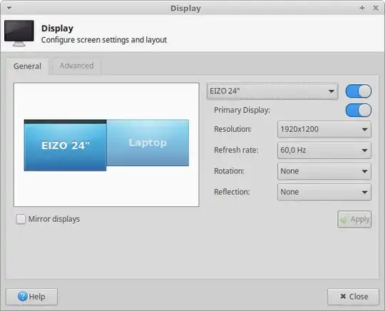

You can adjust the position of your screen, either using the GUI (In xubuntu, using xfce4-display-settings, but I'm sure gnome has a equivalent) or using xrandr.
This is something that you have to do manually, because the computer has no way of knowing the relative physical location between both monitors. They might be top aligned, one might be in the middle, etc. As long as you tell the computer where the second is, you can properly align them based on where they physically are. With a bit of experimentation, you can get something that works very well.
Using the GUI, it is as simple as dragging and dropping. As you can see on the image below, the screen on the right is aligned to the top left of the other one. You can simply click it and drag it, moving it upwards or downwards depending on your preference.
Using xrandr, the relevant setting is --pos.
