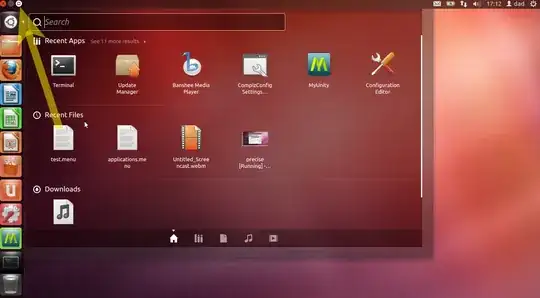

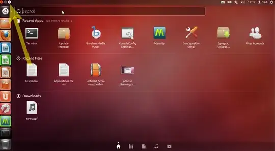

Fortunately this is very simple now in 12.04
First open the Dash
Then click the maximize button:
This remembers the setting between Dash openings and session re-logins.
