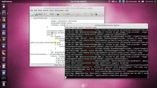

There is a way to make the icons smaller, however the icons are surrounded by backlit that's always 54x54 px and you can't shrink that, it's hard coded. What you can do is this:enter image description here

Original answer:
As of writing this answer, it is not possible to change the size of the launcher icons easily. Georgi's hackish method is the best possible way to change the icon size.
The feature to change the icon size is still not fully developed yet and hopefully, it will land in for 12.04.
See https://answers.launchpad.net/unity-2d/+question/175008.
