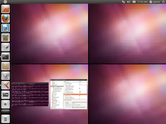

Update for GUI solution
Unity-2D with 4 workspaces (default)
Change the number of workspaces
To change the number of workspaces edit metacity settings, e.g. by running gconf-editor Install gconf-editor and change setting in /apps/metacity/general:
Restart metacity so changes take affect.
Alt+F2, then type in metacity --replace
Your computer will have a temporary seizure, then it will be back to normal - but with added workspaces!

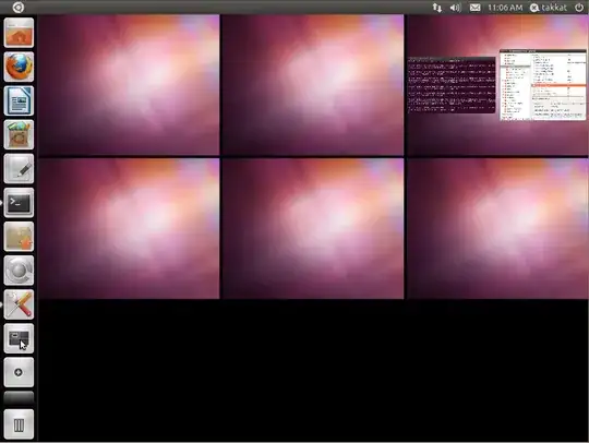

Unity-2D workplace-switcher using 6 workspaces
Takkat
  • 144,580
Execute in terminal:
gconftool-2 -s /apps/metacity/general/num_workspaces --type int $x
where you replace $x with the number of workspaces you want!
For example:
gconftool-2 -s /apps/metacity/general/num_workspaces --type int 4
