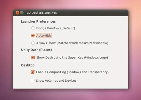

The GUI tool now works in 11.10 as well :) http://marianochavero.wordpress.com/2011/10/14/unity-2d-settings-ui-for-ubuntu-11-10-oneiric-ocelot/
For 11.04
There's a GUI tool to do that.
