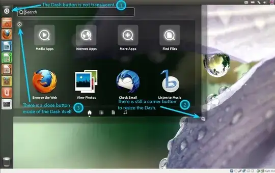

Notable differences in Unity 2D Notable differences in Unity 2D
  1. The Dash button is not translucent.
  2. Other buttons are flat icons, and not transparent/translucent with a glossy appearance as in Unity 2D.

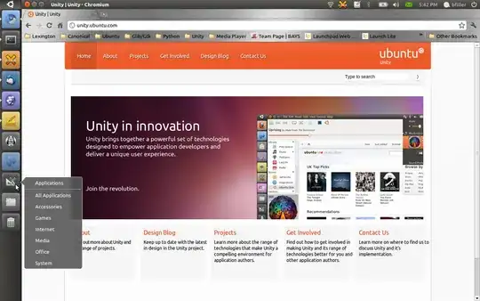

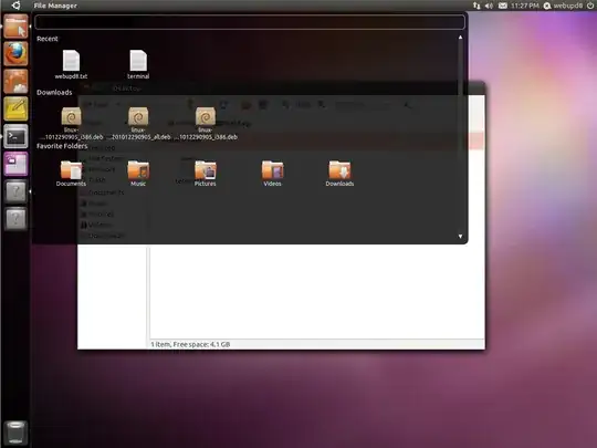

Subtlety in the design of the of the launcher popups - Unity 3D lives up to its name with a darker shadow "3D" effect whereas Unity 2D is lighter and has a "2D" flat effect.
Unity 3D enter image description here Unity 2D enter image description here
