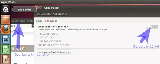

In 12.04 you can control this behaviour in a GUI.
As the picture shows - firefox overlaps the launcher but the launcher doesnt hide because the default is not to autohide.
