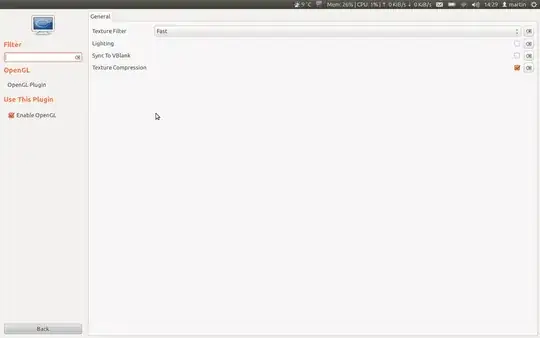

Disable Sync to VBlank. You will have tearing in Videos, however the performance gain for me was huge. enter image description here

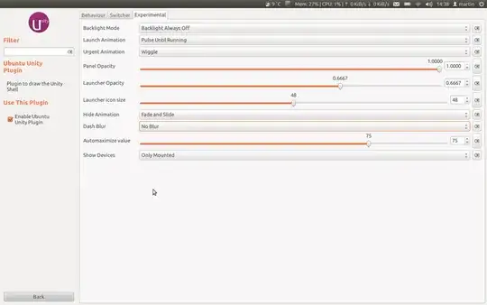

Disable Blur of the Unity Dash. The readability of the dash will be worse, but I get better performance out of unity3d with blur disabled. Screenshot:enter image description here
After these tweaks, Unity-3d actually feels snappier than 2d.
