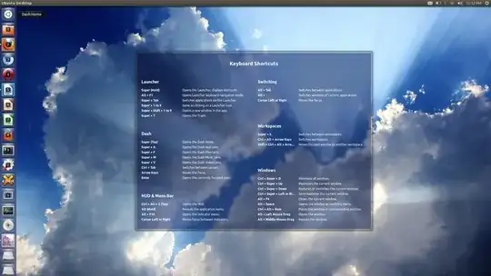

I've made a Unity tricks overlay for the 11.04 default wallpaper.
Click on the image for a full screen version.
If you find a mistake just tell me. Here is the JPEG source version.
Enjoy!

There is a feature in development for 12.04 so that when you long-press the Super key, a detailed overlay of possible shortcuts will appear.
Also notice the numbers appearing besides the application icons in the launcher dock on the left. Super + Number is a short cut to that specific app, to save you from Alt + Tab madness when rapidly switching between three or more apps (such as while programming).

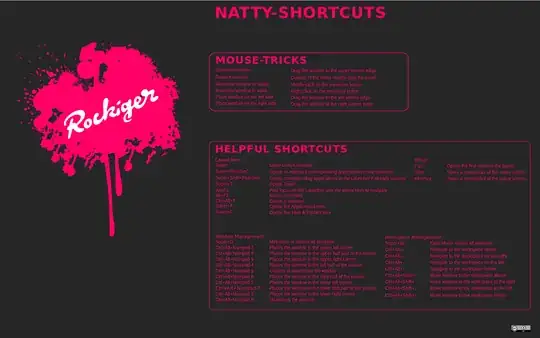

I have found a very good wallpaper, which shows the unity shortcuts: German explanations:
unity Shortcut-Wallpaper (Click on the image for the full size version)
As per demand an English version of that wallpaper.
unity Shortcut-Wallpaper-en (Click on the image for the full size version)

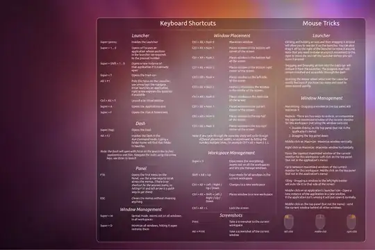

Here's an Spanish version of the first wallpaper:
Natty wallpaper Spanish
If you find a mistake please inform me!

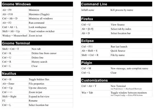

Cheat sheet here . Credits to Chase Seibert

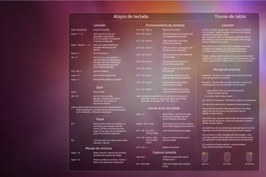

I translate into Spanish the printable version of the shortcuts and mouse tricks. You can grab the ODT here or the PDF here. Please inform me if the links are broken or the translation is bad.
Otra version en español

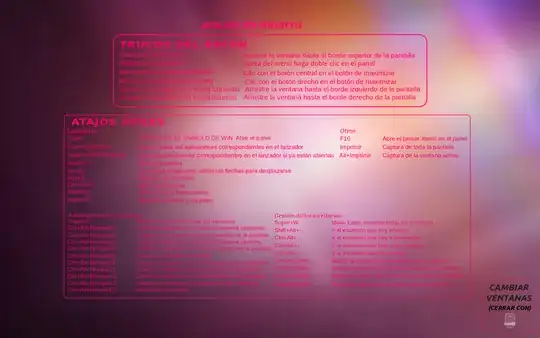

Hi, I made another version of this in Spanish mixing those images. Click for a fullsize image: Atajos ubuntu wallpaper
