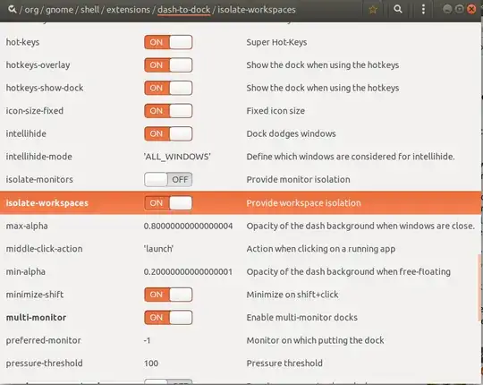

For Ubuntu Dock shipped with Ubuntu 17.10 and later (with GNOME)
Well, Other answers are pretty old, so I think it is worth to add up-to-date answer. It is possible to do so right now and not too hard tbh (With Ubuntu 17.10 and it having Gnome).
Just use dconf-editor:
sudo apt install dconf-editor
Navigate to org > gnome > shell > extensions > dash-to-dock and check isolate-workspaces enter image description here
