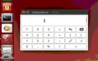

minimize-on-click in action
An unsupported capability was added to Unity for Trusty. Unsupported means that Canonical do not guarantee this capability moving forwards towards Unity 8.

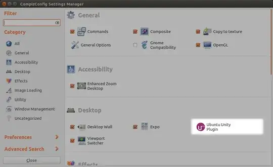

For an unsafe method, you can use compizconfig-settings-manager Install compizconfig-settings-manager:
  1. Launch the application and click on Ubuntu Unity Plugin:

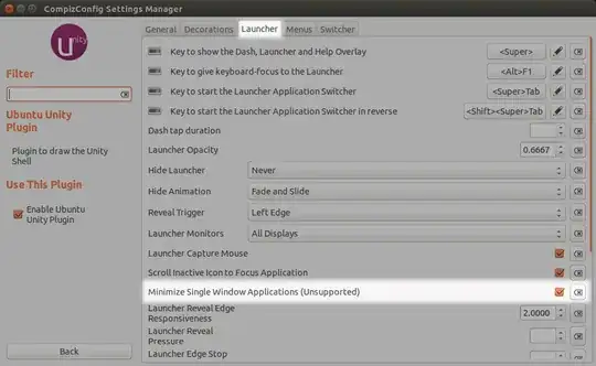

    CCSM Main Window
  2. Switch to the Launcher tab and put the checkmark beside Minimize Single Window Applications (Unsupported) to enable this feature.
    Launcher tab for Ubuntu Unity Plugin

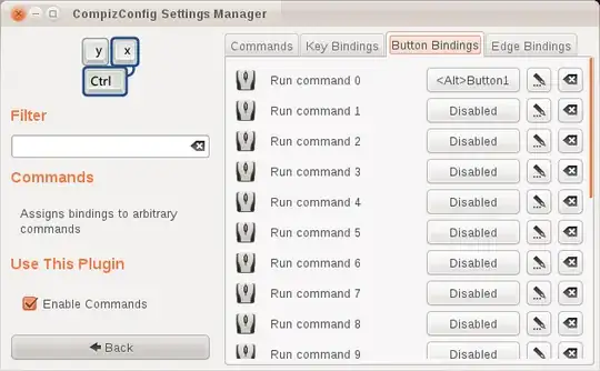

  4. Open Compiz Config
    Use Run Command, Alt + F2, and type ccsm
  5. Enable 'Commands' plugin then add the above script ~/.minimize to one of the empty command lines.
    compiz
  6. Change to Button Binding tab and make a button shortcut for the corresponding command line number above.
    The screenshot example is using Alt + Button1 which corresponds to Mouse left click with the Alt button held down.
    compiz2
  7. Enjoy! ;-)
