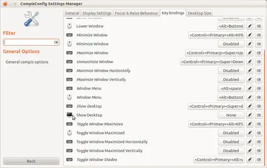

  • To mimic the behavior you want (move to lower right triggers minimize), just install CompizConfig Settings Manager (CCSM) with sudo apt-get install compizconfig-settings-manager.
  • Start CCSM from the Dash, and type "General Options" under filter. Double-click on General Options, select the Key Bindings tab, and find the Show Desktop edge binding as shown below:
  • Click on "None" to get the edge-selection window, and click the bottom-right (or whichever you want) to turn it from red to green. Click OK and close CCSM.
  • Now moving to the bottom right will show the desktop/minimize; moving away and moving back to that corner will unhide the minimized windows.

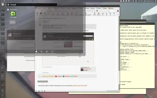

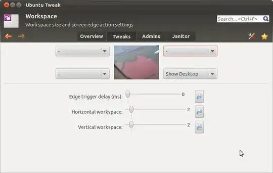

I found an answer that does work on 11.10 !!!
Unity Tweak!
Doing this:
sudo add-apt-repository ppa:tualatrix/ppa
sudo apt-get update
sudo apt-get install ubuntu-tweak
Installs it.
If you start the app...
...you can see the settings:
With or without the app up, now if you move to the bottom right corner , all windows hide.
That's the default on install.

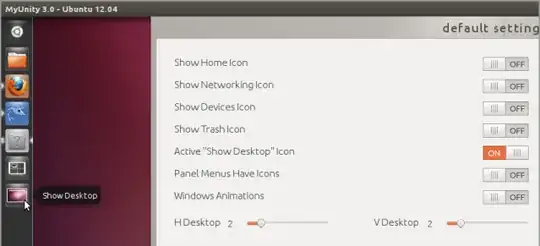

They made this a little easier to do in 12.04, you can install the MyUnity utility (available in the repos), open it up, click desktop, then 'Active "Show desktop" icon. I'm not sure if MyUnity and this method will work for 11.10.
