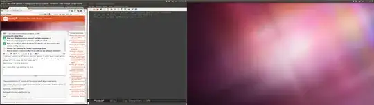

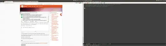

Background: I have just installed two 24" monitors, but this question is about the behavior of each monitor. The aspect ratio of these monitors is much wider than I need, and I would prefer to be able to have four programs open at once, without having to resize each frame.
Question: Can I configure Ubuntu so that an applications open to 1/2 of the screen width by default, and use 1/2 of the screen for 'full screen mode'?
I would prefer a solution that does not depend on Unity, although any solution would be welcome.
Current setup:
Desired Setup: (except that programs are not using full screen in this example)
