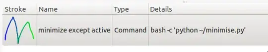

  3. Then start Easystroke. To add a new action click the panel icon and in the Actions tab click Add Action. Use these parameters:
    • Name: minimize except active
    • Type: command
    • Details: bash -c 'python ~/minimise.py'
    To set a mouse gesture click Record Stroke and then while pressing mouse button 2 move the mouse the way you like for this action in future. Ready.
    (You can change the preferred mouse button in Preferences tab with a click on Gesture Button.)
    easystroke settings
  4. To minimize all windows except the active one now just press mouse button 2 and do the action you chose before.
