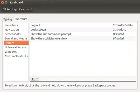

4) The naive approach of using Settings / Keyboard / Shortcuts / System has the "Show the run command prompt" Disabled and italicized, and you are unable to enable it
run command disabled

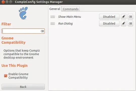

5) Some instructions on the web tell you to use ccsm, the "CompizConfigSettingsManager" under "Gnome Compatibility" and enable the "Run Dialog" but it stubbornly stays disabled:
ccsm run dialog

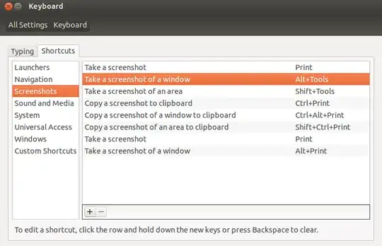

3) You can set up the "PrintScr" stuff yourself in this settings dialog. Use the f13 key and the settings will change it from "Print" to "Tools". Here's a picture of half of the settings having been changed.
