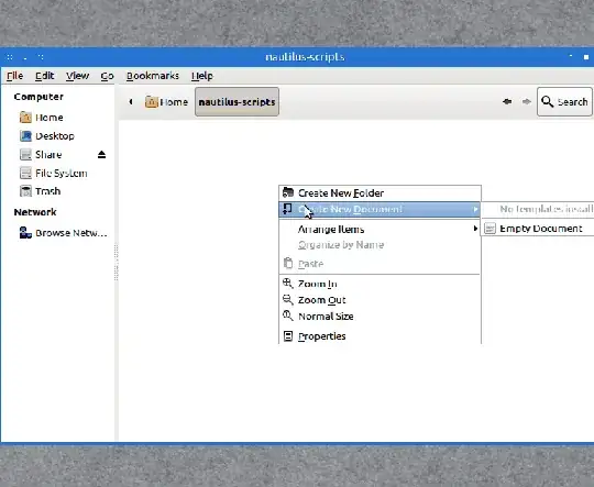

Next we will create a new empty document by right clicking and selecting Create new DocumentEmpty Document. Name it anything you want, but beware: The title you choose is how the script entry will later appear in the nautilus context menu. So better choose a descriptive name for the document:

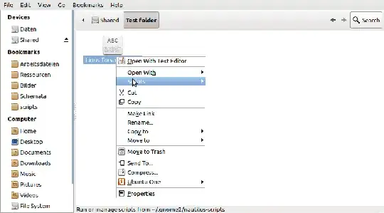

You should now be able to access the script from your nautilus context menu. Just right click on a file of your choice and head to Scripts --> Script name (here: Sample Script). Click on the entry to execute the script on the files you selected:
