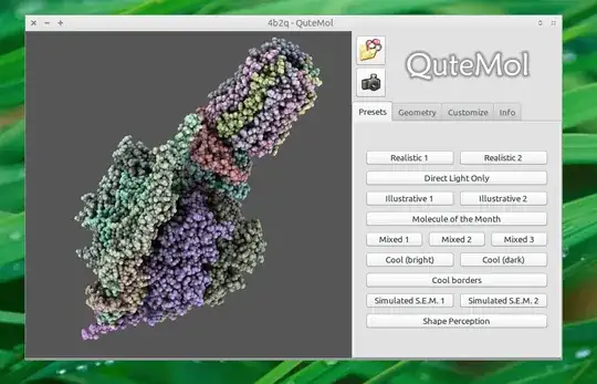

QuteMol
Overview
QuteMol produces some of the most beautiful molecular visualizations I have ever seen. The software is FLOSS and available from the official repositories.
Description
QuteMol is an open source (GPL), interactive, high quality molecular visualization system. QuteMol exploits the current GPU capabilites through OpenGL shaders to offers an array of innovative visual effects. QuteMol visualization techniques are aimed at improving clarity and an easier understanding of the 3D shape and structure of large molecules or complex proteins.
  • Real Time Ambient Occlusion
  • Depth Aware Silhouette Enhancement
  • Ball and Sticks, Space-Fill and Liquorice visualization modes
  • High resolution antialiased snapshots for creating publication quality renderings
  • Automatic generation of animated gifs of rotating molecules for web pages animations
  • Real-time rendering of large molecules and protein (>100k atoms)
  • Standard PDB input
  • Support as a plugins of the NanoEngineer-1 the modeling and simulation program for nano-composites (new!)
QuteMol was developed by Marco Tarini and Paolo Cignoni of the Visual Computing Lab at ISTI - CNR.
Screenshot

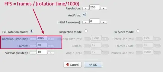

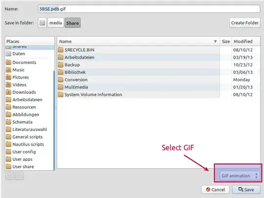

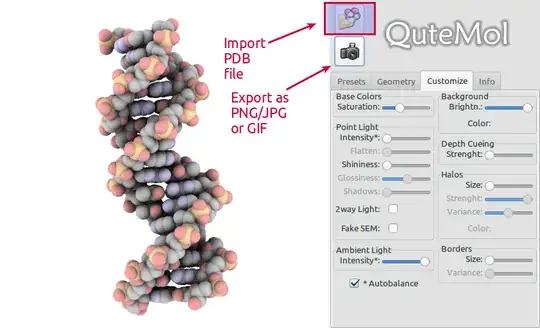

QuteMol is very easy to use. Open a PDB file of your choice, adjust the view and hit the export button:
Make sure to choose the GIF format:
Select the rendering mode of your choice. You can set the FPS count by adjusting the rotation time of the animation and the number of frames:

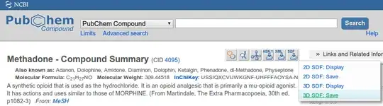

Good sources for 3D MOL/SDF files are Pubchem and ZINC. Make sure to choose the 3D SDF option when downloading files:

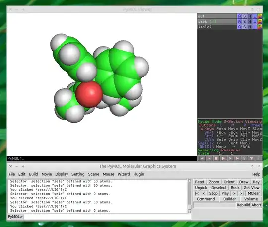

PyMOL
Overview
QuteMol is a fantastic little program but quite restricted in terms of rendering modes and image manipulation. For more advanced handling of compound visualization you might want to check out PyMOL. A tutorial on how to create simple animations can be found here. I would have written up a tutorial here but I am not proficient enough with PyMOL to do so.
One last thing, though. If you want to achieve a similar graphical fidelity with PyMOL as with QuteMol you should check out these blog entries:
http://cupnet.net/ambient-occlusion-pymol/
http://lightnir.blogspot.de/2008/09/cute-molecules.html
Screenshot

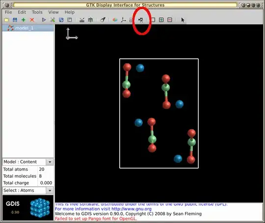

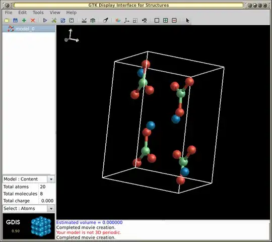

Once you open the application, go to File --> Open.
  • From there, navigate to /usr/share/gdis/models to open up a sample file:
-- For this example, open up the file /usr/share/gdis/models/arag.gin:
In order to run a rotational animation of the molecule:
  • Select the record icon on the toolbar:
  • Right click on the molecule and drag your mouse for several seconds

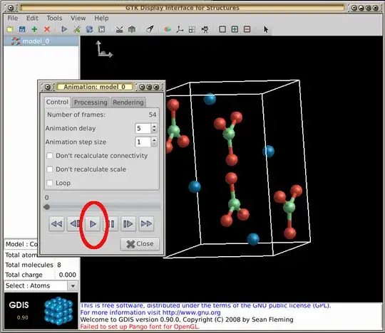

  • Return to the menu -- Select Tools --> Visualisation --> Animation -- Now, select the Play button to replay your manipulation of the molecule:
For a basic tour of GDIS, take a look at their tutorials.
