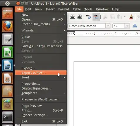

Just open the document with libre office and choose Export as PDF...:
