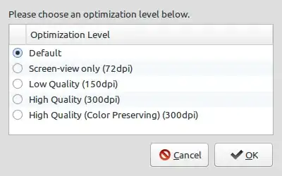

I have been able to successfully resize my PDFs with this Nautilus script:

        label_level="Please choose an optimization level below."
        optimization_level="Optimization Level"
        level_default="Default" # apparently close to High Quality
        level_screen="Screen-view only (72dpi)"
        level_low="Low Quality (150dpi)"
        level_high="High Quality (300dpi)"
        level_color="High Quality (Color Preserving) (300dpi)"

Screenshot
Compress
Options
The options offered in the zenity GUI dialog correspond to these ghostscript settings:
  • dPDFSETTINGS=/screen (screen-view-only quality, 72 dpi images)
  • dPDFSETTINGS=/ebook (low quality, 150 dpi images)
  • dPDFSETTINGS=/printer (high quality, 300 dpi images)
  • dPDFSETTINGS=/prepress (high quality, color preserving, 300 dpi imgs)
  • dPDFSETTINGS=/default (almost identical to /screen)

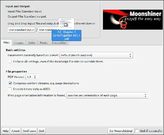

Moonshiner
Overview
More advanced control over your PDF output can be achieved with Moonshiner, a GUI front end to ghostscript.
Installation
Moonshiner is not available from the official repositories. Unfortunately I wasn't able to find an official PPA, either. There's only this private PPA which hasn't been updated in a while. The .deb archive available here should work on recent Ubuntu revisions, but don't take my word for it.
As far as I can see the safest way of installing moonshiner is directly from its source. To do so, first download the most recent revision:
svn co https://moonshiner.svn.sourceforge.net/svnroot/moonshiner/trunk moonshiner_svn
cd $HOME/moonshiner_svn/
Moonshiner depends on Python, PyGTK and Ghostscript. If these dependencies are satisfied (which they should be on a stock Ubuntu installation) you can proceed to install the application with:
sudo python setup.py install
Or with python's packet management tool (sudo apt-get install python-pip):
python setup.py sdist
sudo pip install $HOME/moonshiner_svn/dist/moonshiner-1.1svn.tar.gz
Uninstalling moonshiner is a breeze with pip:
sudo pip uninstall moonshiner
If you go with the first installation method you will have to remove all installed files manually.
Usage
After installation you should be able to launch Moonshiner from the dash or your preferred application launcher. The GUI is pretty self-explanatory. To modify a PDF you simply drag and drop the file onto the interface, change the settings you want and hit Go Moonshining!.
Three separate governors under the Images tab allow you to fine tune DPI and quality settings to your will:
http://i.imgur.com/Y5ziLnu.gif
I won't dive into the other settings here but I encourage you to consult the official documentation for any questions you might have.
