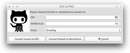

Graphical Nautilus Script
Overview
The command line is great for batch conversions but sometimes you just don't want to leave the comfort of your GUI. That's why I coded a GUI-based Nautilus script to batch convert SVG files to PNG images. Other file managers with custom actions (e.g. Thunar) should be supported, too.
Screenshot

Usage
After installing the script you should be able to invoke it from your file manager's context menu. Simply select one or more SVG files and click on the appropriate entry in your context menu. A GUI dialog should come up with several options concering the conversion.
You can either convert the SVG based on DPI or width. The aspect ratio will be conserved in both cases. Make sure to supply your DPI or width of choice before clicking on the conversion buttons.
You can also choose between exporting the full SVG file or only the cropped drawing. If your SVG canvas has a lot of empty space it's advisable to choose "Drawing" as the export option.
