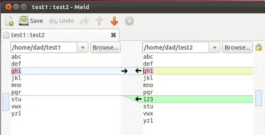

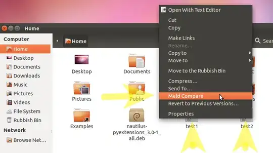

There is a useful python extension that incorporates Meld into Nautilus
how to install
Obtain the source or the deb package from the authors website.
wget http://www.giuspen.com/software/nautilus-pyextensions_3.4.1-1_all.deb
sudo apt-get install python-nautilus
sudo dpkg -i nautilus-pyextensions_3.4.1-1_all.deb
Search for pyextension in Dash and run Nautilus PyExtension.
Activate the meld extension (install it if asked) and click the restart Nautilus toolbar option.

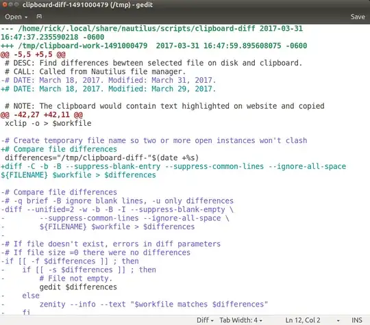

Using Nautilus to compare file to clipboard containing text
This answer is primarily used to compare a file to text in the clipboard that was copied from the internet. The clipboard text could have been copied from another file on your system though--making this an eligible answer.
File differences are highlighted using bash's native diff command and then displayed using gedit. This can be modified to meld or any other third party package though.
This answer uses Nautilus's built-in function to run a custom script after selecting a file:

NOTE: I developed this Nautilus script a couple weeks ago and have been meaning to post it as a new Q&A but have been pressed for time and was unsure if anyone would really be all that interested in it.
Sample output
clipboard-diff 1
In this example we're comparing the actual script posted here in AU prior to March 31, 2017 to the version revised on March 31, 2017. Notice how new information and error messages were setup.
The diff command is very powerful and as such has a myriad of control parameters. Type man diff in the terminal for the manual pages or info diff for more even more command usage details.
