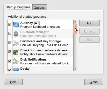

Disable automatic startup of any services that are not needed (or even remove the package completely).
A lot of packages start up services automatically. These services then use memory and CPU even they are hardly ever used. It is better in this case, to stop those services, or take them out of autostart, and start them up only if they are needed.
To remove applications from starting up on 10.04,go to System > Preferences > Startup Applications (may be slightly different on other versions)
On 12.04, you can go select the startup applications by clicking on the Dash Icon. Then, type startup and select "startup applications".
alt text
And just unmark the apps you don't need. But be sure about it, don't just remove apps you don't know. If you are not sure about one, leave it that way. A google search or new question here about specific programs will help.

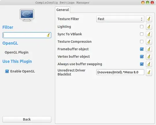

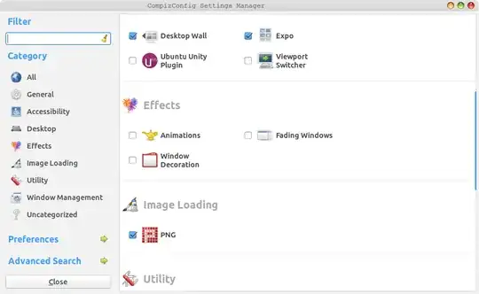

On one Ubuntu machine I have, I found that setting desktop effects to none (disabling all the graphical effects) made a huge UI speed improvement.

Found what was slowing down my machine: gwibber-service. Maybe because I have an account in twitter that follows a lot of people and when it refreshed the machine went bad.
I was monitoring the machine with top as said @kmassada and when it was really slow noticed the process. Then executing:
sudo sed -i 's/NoDisplay=true/NoDisplay=false/g' /etc/xdg/autostart/*.desktop
as @blasmat indicated to go through Startup Applications I could see that the service started automatically and I disabled it. Now my computer is much faster. I think there are still improvements I can make (I don't feel it at it top conditions), but after 20 hours of testing the performance I can say it really goes well.

Another good way to boost performance is to install CompizConfig Settings Manager, and disable animation effects, Fading Windows, and Window Decorations. Desktop wall and Expo are an option, too.
Also, use fast texture filter under OpenGL

I would also check my startup applications to see what runs at start up and what I don't need to run at start up.
