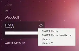

Install this Install gnome-session-fallback gnome-session-fallback
And them you will be able to open a session with GNOME Classis (No effects).
I think that GNOME Classis (No effects) is the one using less 3D features.
To select it, just click on the little cog icon.
