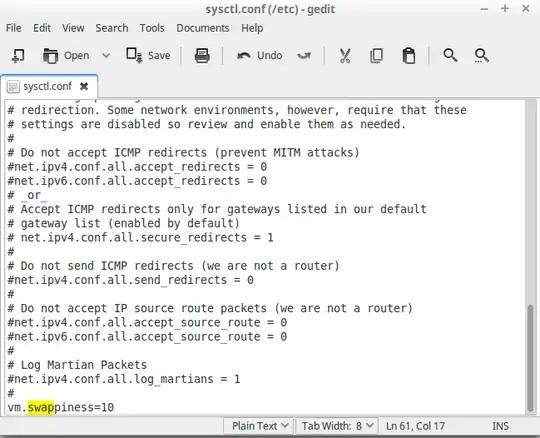

  • decrease swappiness (when using SSD, this is the "must have"), deault value is 60... if you go to for example 30, Ubuntu will write more data to RAM rather then SWAP on HDD, which is slow.
gksu gedit /etc/sysctl.conf
look for vm.swappiness=some value, if that line doesn't exist, you can simply add this line as:vm.swappiness=value you want
