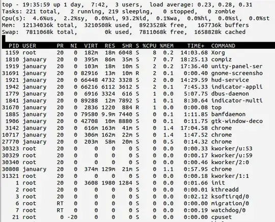

OK, so I don't know what the particular problem here might be, but here is a very basic approach that I usually take in such a case. Forgive me if you think it is too simplistic.
I usually open a terminal window and type
`top`
This is a terminal (ncurses) based program with a not very intuitive interface; there are more elaborate graphic alternatives, but I prefer this, because in itself it takes next to no resources.
By default, the list is ordered by CPU usage. However, pressing SHIFT-M sorts the list by memory usage.
I keep this window opened, either on a second monitor or resized to take 1/5 of the screen and "always on top". I start working normally, and watch the window. After a while it becomes apparent what are the main problems.
For memory, google-chrome is often one of the culprits (I'm one of these who open pathologically many tabs). For disk usage, watch for anything with "io" in the name. Do that, and post the results. Preferably at times when you would expect the OS to run smoothly (ie not while watching a movie).
