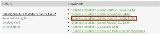

Well, Ubuntu 14.04 is quite more resource intensive than many previous releases. I think with your specs, you are pushing the envelope when it comes to speed. I've used an Acer Aspire One (with the N455 Atom) the only problems I had were incompatibilities with with the Intel GMA. Ubuntu also runs a lot better with a minimum of 2GB of RAM. Also, even though your processor is 64-bit, you might wanna try 32-bit Ubuntu: that would be a less resource intensive option.
To get drivers for you intel GMA graphics, find your download here: https://01.org/linuxgraphics/downloads enter image description here
