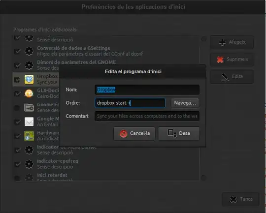

You should have a look to which programs you installed are running in the background after login, and remove the ones you don't need. The programs would be still installed, but won't run until you need them. In a terminal, type:
gnome-session-properties
You'll see something like this:
Just don't disable any program before knowing is safe (search the names in the web, to see what their function is).
